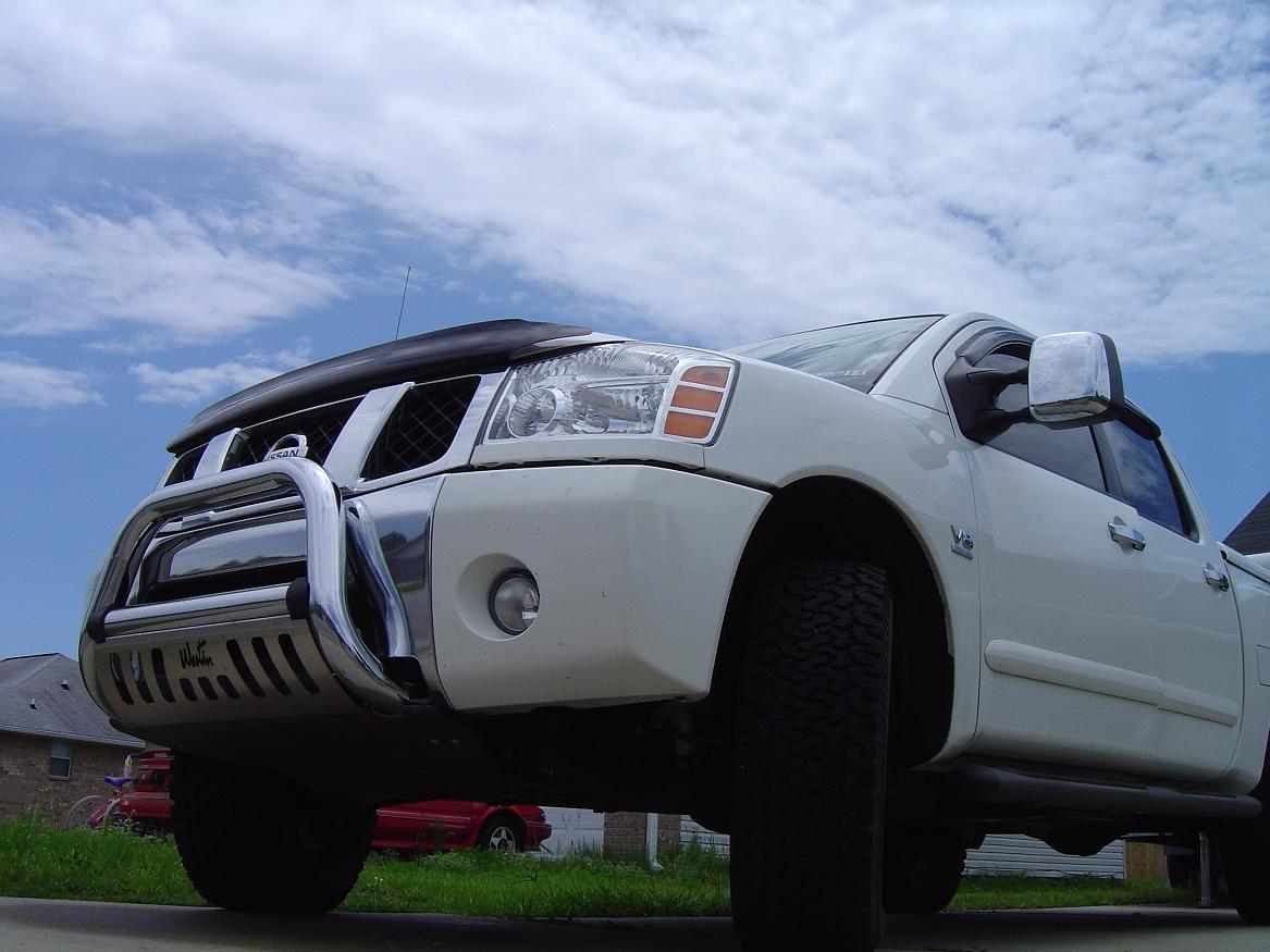

I went and did it. I was able to put some BFG 315/70-17 AT on my titan with a nitrousenterprise 3 inch lift. It only needed a little fixing in the back of the fender. I just bent back the pinch weld and pulled the plastic back. It was real easy to do. And they are free and clear with no rubbing. The ride is really the same as stock. The only thing is the little hum from the tires. Man I love it. Rock sliders are next on the list of mods to get more side protection and clearance. Even my wife loves it.

Sweet. Looks real good. It looks like you don't even have a tire on the front driver's side in the first pic. I like the pic of the truck in front of the plane. It looks like a Blue Angel jet. Is it?

I am wanting to put a lift on my truck and I was wondering did you do it yourself? and is it possible for the average idiot to do?

I have to say I thought I was the village idiot. I did do it my self and it realy is pretty easy. I would make sure you have access to air tools. They help out a lot. The guys at nitrousenterprises walked me through it. One other thing to be sure you have access to is something to compress the spring on the struts to change out the bolts. Other than that it was real easy.
